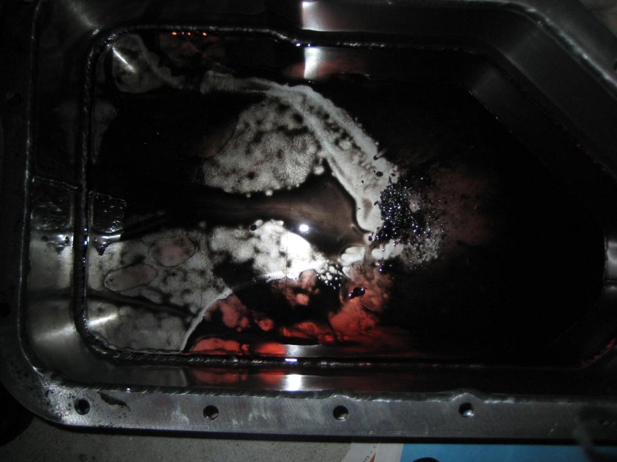

I've changed to the MotoTron 60# injectors. Also dropped the pan to install a new pan gasket to cure the leak, and to have a look inside.
As expected, I have some clutch shards inside. Not sure if its more than I should expect or not. Any thoughts? This is probably 20 brake launches worth.
Starting to think that the whole transbrake thing is basically a bad idea. It hasn't resulted in great launches, though it does keep the car still and not creeping through the lights at launch. What else it does seem to do is shell a set of clutches in a short time when used at the track.
So...not yet sure if this or a misadjusted TV is the reason for the funny shift behavior.

That looks like a LOT of clutch material for the short time you've been running it ...
Also, I've never liked the brakes on the 200-4R ... awfully hard on the trans AND it's a totally different "shock" to the drivetrain vs. foot braking.

all transbrakes will be hard on the trans and driveline,
The trans will hold up fine, if the trans is built properly and the transbrake is
operated properly
You know as well as i do, there is only a handful of people in the US that can build those 200-4rs to last
We have had over 150 20 psi t brake launches on the 87 limited, and the fluid still looks great
Its all about having the right converter and good trans builder

I'm trying. I'm trying...
The fluid was actually nice and red. It didn't smell like a rotting corpse and have the consistency of chewing gum...like the last builder I used. So there is some hope here.
