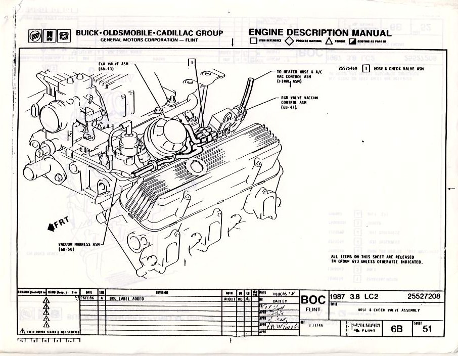

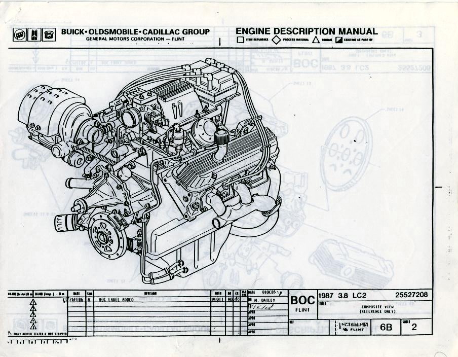

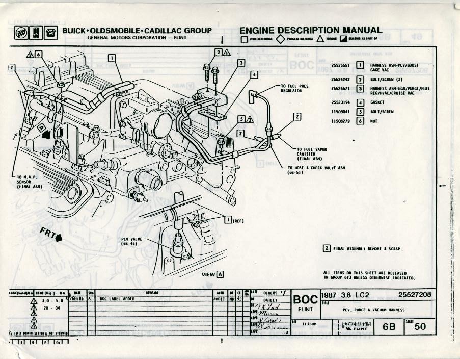

I am putting together a 87 T/T-type for a friend and all of the vacume line info is missing. They put in a new motor and I am tring to get it to run correctly and found a lot of vancume lines blocked off and tring to make it right again. Need a 87 GN or T/T-Type vacume diag for the heater valve and all of the sensers. I remember most of them just need a good blueprint to work from Car does not have cruse on it so I understand to block off the line to that option just could not find a 86/87 vacume diag. only an 84 and it is little diffrent. Please Help....
Thanks.

These may help a little ... not complete routing, but maybe give you a good starting place.
