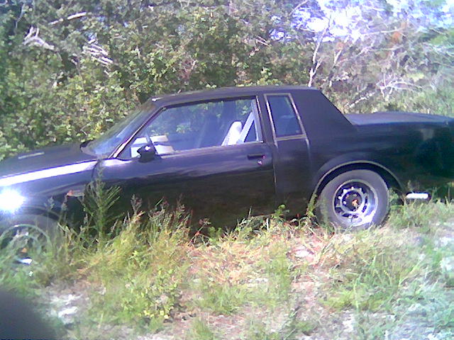

Default Re: Buying a GN - What to watch out for
Here is a pic. I will get some better ones next week.
