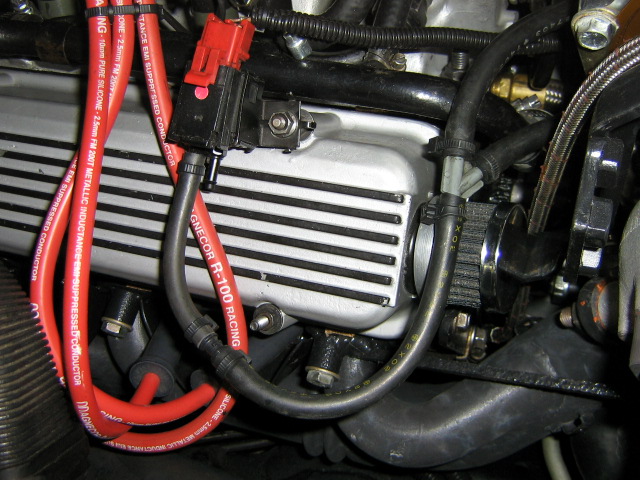

I reviewed the sensor locations via the resource link, and I have a question. On the passenger side valve cover at the front of the motor is a sensor with two pins. If the resource guide is correct it's the wastegate control solenoid. On mine, ther is a short piece of hose about 2 inches long that goes nowhere. It looks to be of natural rubber or something; it is brown, not black. There is also a second hose thats plumbed into vacuum. Where should the other one go?

One side of the wastegate solenoid is vented to atmosphere. Had a little foam cover on it from the factory that quickly fell off.
The other side (they are interchangeable) goes to your turbocharger wastegate and turbo compressor via a metered "Y" whose orientation is critical.

Sounds like you're missing the wastegate solenoid hose assembly. Here's a link and discription from one of the vendors. Also a picture of mine. Notice the grey colored plastic Y where the hose splits.
