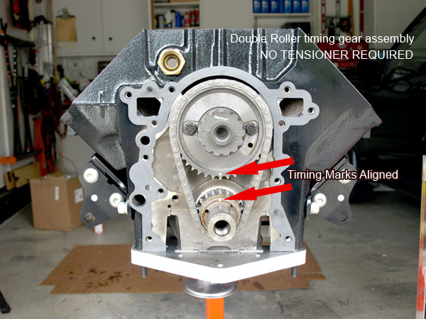

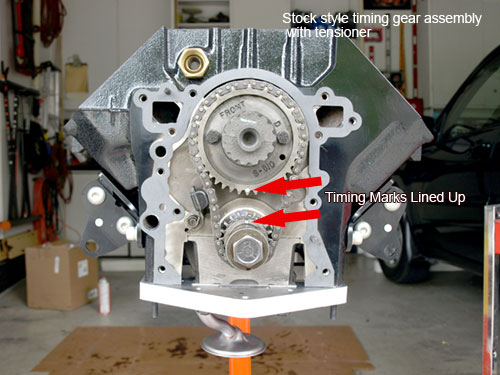

I have seen a lot of posts on were to align the timing marks, so when I was putting my motor back together I took some pics... One of a stock timing gear set up and one of a double roller style... Hope these help others in the future... Tom G.

Pics of timing mark setup is correct as long a #1 piston is at TDC. Use a dial indicator if necessary to get TDC.
