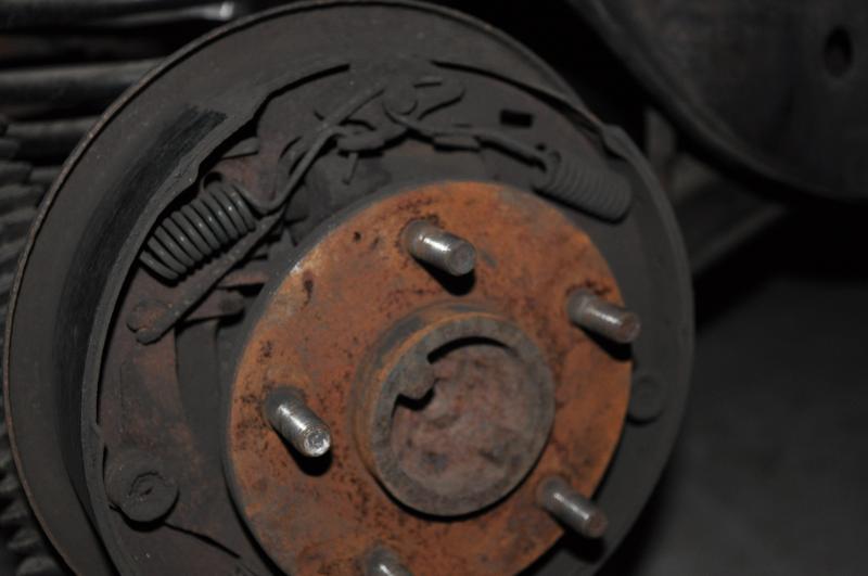

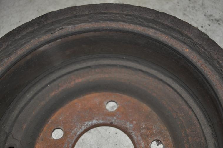

How bad does that look?

Looks worn, but not destroyed. The drums would have to be measured to see of they still have life and just may have to be turned or would have to be replaced.

Looks like normal wear. I don't see any axle seal leakage from your pics or any wheel cylinder seep...Follow Scotts' suggestions on the parts and tools you should be OK. Going with the bigger wheel cylinders is a good idea. When you have the large upper brake springs, out drop them on the floor and listen for a thud sound. If they thud they are OK, if they twang, they are stretched and need replacing. Just get a brake spring hold down kit at you parts store and you will be good to go... Good luck Tom G.

I could make the spings stretch a little by hand. They were no where near as tight as I thought they would be. I will just get the new springs. As far as the cylinder goes, should I just change it out to be safe, or do they last pretty long? I'm not concerned with holding boost, more so with stopping distance. I'm probably going to get the these shoes unless you guys know of something better and cheaper.

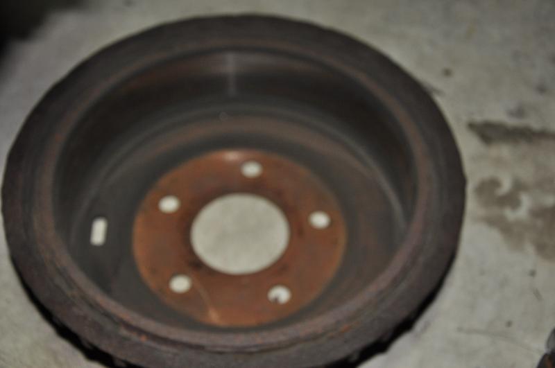

Also, I don't think my drums are aluminum. They're rusty. How do I know if they're aluminum?

With over 100,000 miles on the car and probably original wheel cylinders I would change them out... Nothing worst than putting on new lining and having an old wheel cylinder start leaking... Those look to be cast drums. Aluminum do not rust on the out side... The shoes should be fine. You said you were more of a sunday driver than racer. Tom G.

Never seen an external adjustment hole in an OEM drum like that. You'd know if it were an aluminum drum. They don't rust, first of all. Secondly, they are much lighter. They have large, circular balance weights on the face, very often. And they are only on open rear end cars to my knowledge. I don't think you can find them in the aftermarket; only wrecking yards.
